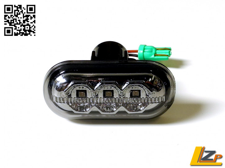

    I propose you replace the original door side bulb indicators with LED indicators. They consume less power than Halogen bulbs. This should help to cure the overload issue.
    LED side indicators come cheap and are easy to install. I use such:
    https://www.lzparts.de/licht-s…hrome-smoke-dacia-renault
    No problems so far.

    So finally, I replaced my side blinkers by LED.
    I noticed that the problem is still here but appears after around 20 minutes of hazard lights on.
    Before replacement, it was appearing after 2-3 min. So it’s better but still here.
    Just to let you know.

  • So finally, I replaced my side blinkers by LED.
    Tell me what number of the side turn signal or did you replace it with a non-original one?
